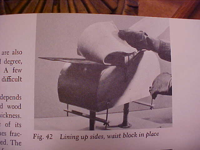

First let me say, I just found these pictures interesting. From a book I got during the Swap Meet. Printed back in 1966, the methods described were the result of ten years of study, so they date to 1956. Hey, I was four years old.

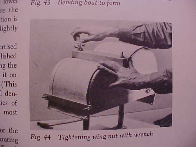

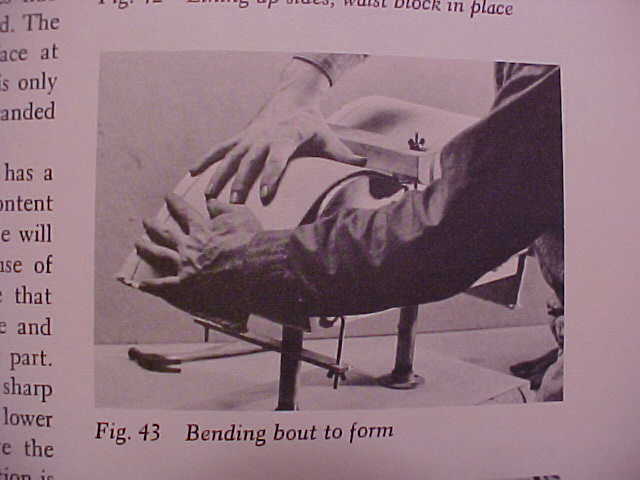

The sides are boiled in a vat, then a heavy canvas applied to the wood steeped for 1 1/2 hours in boiling or near boiling water, and over a guitar shaped form.

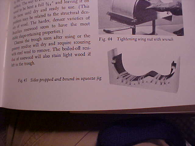

The bolts are tightened into position, waist caul first, then the upper and lower cauls. Place in a heated room or in sunlight and allow to dry. Use heat lamps during high humidity and with maple. Otherwise leave the form undisturbed for a week.
Then put the sides in a squeeze jig and bind the sides propped to an exagerrated degree.
